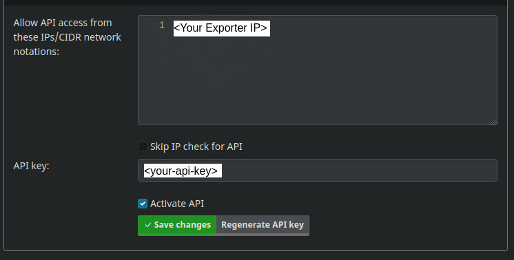

The /metrics endpoint requires host and apiKey URL parameters. host is the hostname of your mailcow instance. apiKey should be a readonly API key that can be generated by logging into the mailcow management interface and navigating to 'System > Configuration > Access > Administrators > API keys'.
The API page describes how to create the key and allow access from the IP address of the exporter.
Important: Restrict access to the exporter and protect your API key!

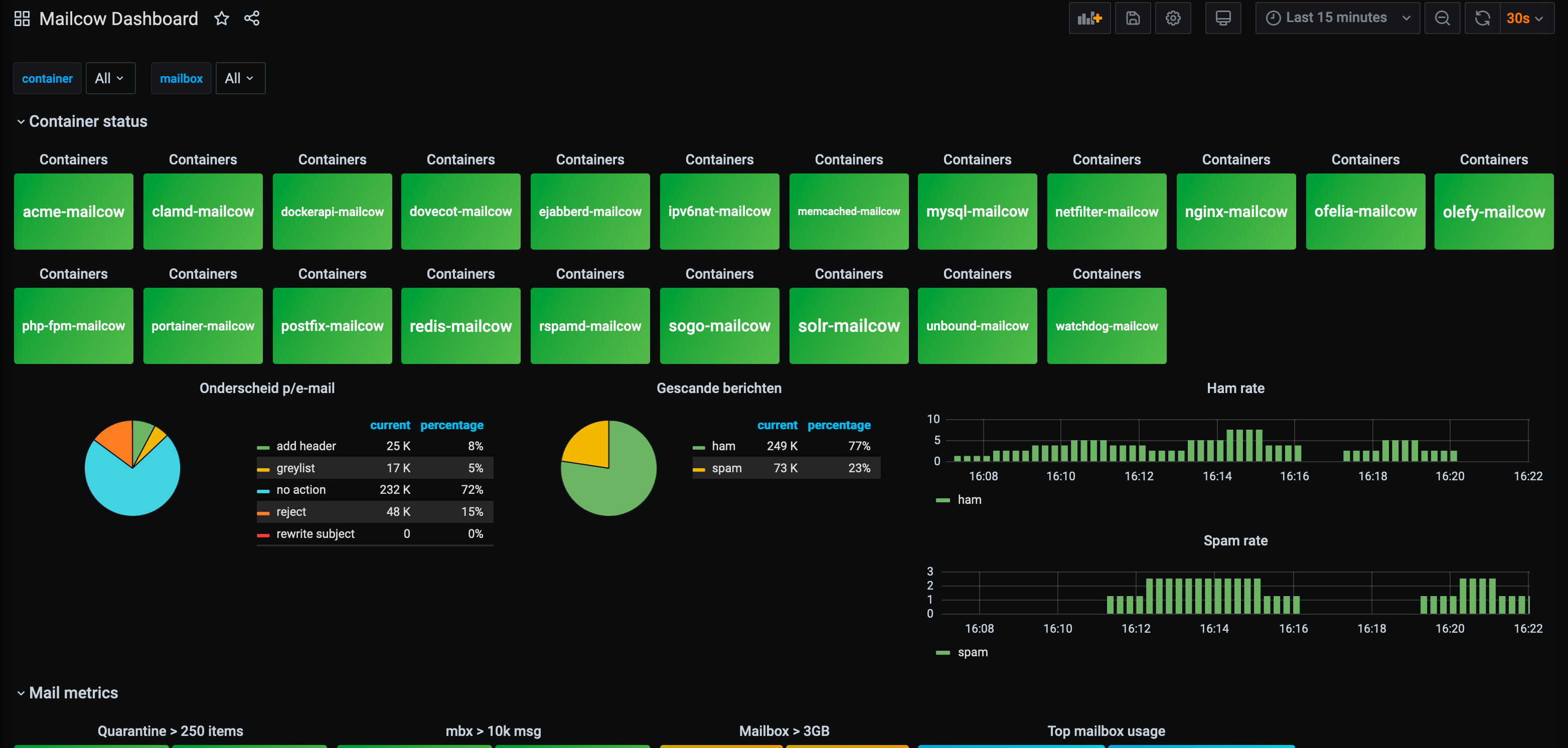

Example metrics
HELP mailcow_api_response_size Size of API response in bytes
TYPE mailcow_api_response_size gauge
mailcow_api_response_size{endpoint="api/v1/get/domain/all",host="mail.example.com",statusCode="200"} 2198
mailcow_api_response_size{endpoint="api/v1/get/logs/rspamd-stats",host="mail.example.com",statusCode="200"} 1950

Grafana Dashboard
Grafana The open and composable observability platform"
A screenshot to show how the dashboard looks like Mailcow screenshot This dashboard was adapted from remkolodder/mailcow-dashboard by [Remko Lodder].
